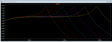

This is a fairly straight forward non-inverting opamp gain stage, Baxandall style Bass and Mid tone stack, inverter stage to keep input to output polarity the same, and then a second order Sallen-Key low pass filter, with swept frequency and variable resonance. Frequency sweep range is ~300-8.2kHz, resonance is variable from full cut mode to about a +12dB resonant peak. The inspiration for the treble section is mostly taken from Alembic and Wal onboard filter preamps. Although this build was a through hole board with SMD opamps on adapters, you could duplicate it functionally with two modular hybrid SMD boards available as a share from OSHpark via my GitHub repository here: https://github.com/Passinwind/PW3B-LPF/blob/main/V4 Schematics and BOMs.md

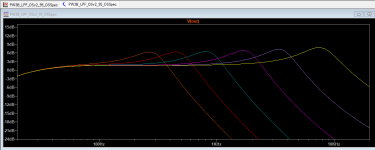

LTspice sims for the resonant LPF response curves at max resonance, an intermediary resonance, and minimum (full counterclockwise):

I also put up a revised schematic, as I did an opamp swap to see if it would improve the noise floor. Maybe a tiny improvement, but if nothing else now it’s two of the same ones. Because it’s a surface mount part I was able to do the swap in well under ten minutes, with no need to pull the PCB out of the enclosure…yay!
