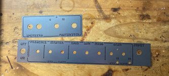

A good way of doing tolex is to lay the box down in the center of the tolex, spray the side of the box and the tolex on that side. Then you carefully tilt the box over on top of the glue, then you spray what was the bottom and the tolex on that side and flip it back. Etc. This way everything is pre-positioned so there's no messing around with trying to align insta-stick glue.Antique Electronic Supply has 10% off right now for Memorial Day so I went ahead and bought all the hardware. I think I am going to build a cab out of wood rather than buy the Hammond cage cover thing. We will see. I still have PTSD from my last tolex attempt hahaha.
