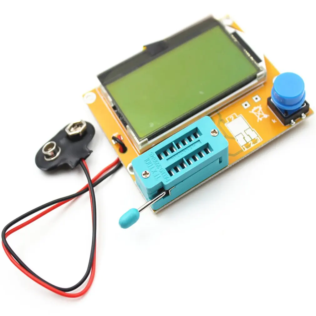

I'm looking to match some jfets for the upcoming phase90 and I'm wondering if anyone has any experience using the "lcr-t4" tester to do this. It looks like it can measure a lot of things which would be nice as my multimeter doesn't measure capacitance, but if it's not going to work for jfets I don't see much point in getting one.
Thanks.
Google "jfet matcher". 10 components maximum. T4 is not the best choice for jfets.
Thanks for your reply. I was looking into the t4 because I was going to use SMD and it seems a lot easier to set up. Would you say it's good enough or is it not going to give good results?
Thanks.
edit: are there any good alternative "all-in-ones" that I could look at?
I know that SMD test pads are tempting but T4 often recognize jfets as bjt transistors. This issue has been discussed here and there many times. Good alternative - Peak LCR meters. Much more expensive. That's why I suggested diy matcher.
