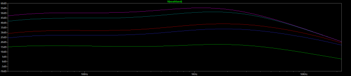

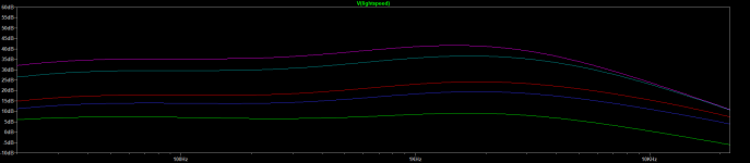

Here are models. First up is the gain sweeps. Note due to the 1Meg pot we do see more treble roll off on the southland with the 100pf capacitor at the highest gain settings. This is with volume at 100% and tone at 5k ohms.

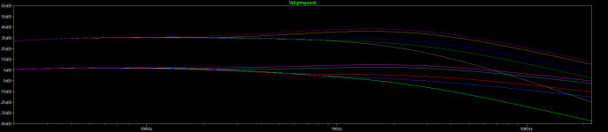

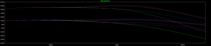

Next up is tone sweeps with gain at 0 and 100%

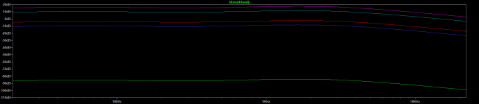

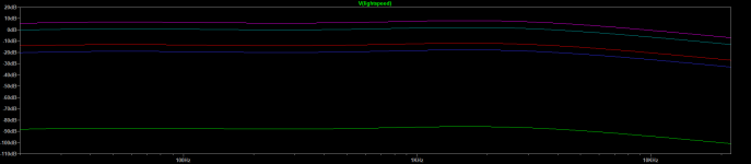

Finally here is gain at minimum, tone at 5k, volume sweep.
I think the "mid-scooped" tone that people are hearing must either be due to the high end roll off of the larger gain pot, or how they use it with their extra clipping maybe making the preferred tone setting different?
I think it could also be the hard-clipping itself, which'll generate different harmonics than soft-clipping by itself and change what we hear
