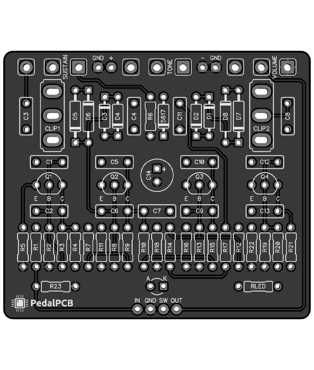

MST stands for Minotaur Sonic Terrors. The Swamp Lord is their take on a Muff, housed in a comically large enclosure. The bass player of the band we share the Doom Room with has on of them, it sounded pretty cool, so I looked for a PCB .... and found a vero layout.
It's basically a Muff with Mids and clipping options. There are 3 pairs of diodes, I left one pair stock (SI/GE) and changed the other two pairs (both SI in the original) to one pair green LED and one pair red LED. I also used other tranistors, BC550C instead of BC239C.
It sounds massive, the mids knob has a great range.
