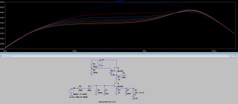

This one is nothing revolutionary but sounds amazing and was fun to develop: idea -> LTspice -> breadboard -> eagle -> final build
I've always liked the way jfet boosters and overdrives sound with solid state amps (the kind of amp I play the most) and so I've decided to try some MuAmp (in large part thanks to Chuck's Boneyard) with a Range potentiometer of sorts that mixes a 2u2 bypass cap in parallel with a 100n.
I've used two 2sk117-Gr transistors, that give just a tiny bit of dirt with single coils. It distorts a bit more with humbuckers, but is cleaner than a typical rangemaster.
