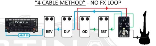

So I check the noise gate in situation with no FX loop and 4 cables methode , it appears that the effect is too much delicate with Nux Cerberus, when I use clean sound , the noise gate is too present, and I'd like to not switch off the Muzzle! 😒
And when I want to separate overdrive circuit and space/modulation circuit with the Nux Cerberus , the noise gate has no reaction.:(
I'll check it with my Mesa Boogie FX loop, but with my pedal board and the Nux, it is not very handy....

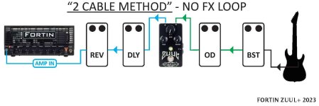

The Muzzle pedal was evaluated yesterday at the rehearsal, it works fine! No loss in the clean or OD/DIST sounds with fine adjustment of the threshold! (y)
Simply with 2 cables method with no FX Loop, it works fine and definitively this pedal will be present on my pedalboard.
If I use 4 cables method , there's too much latency! (n)
So what's the real use of the sidechain circuit? A buffer ?
