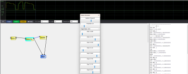

Here's yet another new release, with some rather cool new blocks.
  • 4-Phase Sample/Hold block — Enabled in Controls menu. Uses sine LFO zero-crossing detection to sample input at 4 phase points (0, 90, 180, 270 degrees), producing 4 independent S/H outputs
  • Pattern Generator — 8-step triggered sequencer with range control
  • Scope Probe block — New block for simulator signal inspection
4-phase sample and hold puts out 4 separate S/H waveforms from a single input using a built in SIN LFO. The points where the S/H takes place are evenly spaced along the cycle. I haven't done much more than test it but I bet you can get some weird combinations of gain (tremolo) and filter or modulation effects with this. The last pin on the bottom is the sine wave out, I think I'll remove that. You can always use an "LFO Value" block if you want to use that somewhere else.
Next one is a 3-to-12 step pattern generator. This lends itself to ZVex "Seek Wah" type applications. If you connect a pot or signal to the 2nd pin (Range) it allows you to shorten the sequence. This one has a threshold as well as a setting for slope. If you're using either positive or negative slope only, then the triggering will be evenly spaced and follow the frequency of the input signal (e.g. sine). If you trigger on both, then by changing the threshold you can get asymmetrical swing type effects and the frequency will double.

I would recommend the use of the "Scope Probes" along with the Simulator display to visualize the AMZ Noise, Sample/Hold Output, etc. down the line.
