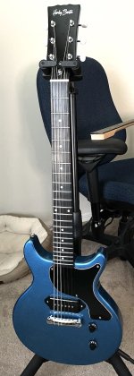

I was so impressed with the Harley Benton "Jaco" fretless bass that I got recently that I found myself looking at the Thomann site at what else Harley Benton made. A Les Paul Junior was something on the way back burner for me, and I was actually thinking about building one at some point and using that as a platform to dip my toes into doing a full finish on a set neck guitar.
The "Junior" is somewhat of a specialty guitar and you kinda have to "get it". A of people don't appreciate all the various sounds, tones and applications you can get out of a single pickup guitar. A lot of it is in manipulating the tone and volume controls, a lot of it is in your hands and how you play it. I won't claim to be proficient at it yet, but it was actually watching Tommy Bukovac's video's and hearing him play and talk about his Juniors that got me interested again.
Single pickup guitars just have something about them that makes them sing in a different way. My personal opinion is that the absence of a second or 3rd pickup reduces the magnetic pull on the strings allowing it to sustain longer and have more harmonic content. But I can't prove that empirically, it's just a SWAG.
Anyway, there's a whole host of interesting extremely affordable guitars and basses from Harley Benton and my understanding is that they are sourced from different manufacturers by Thomann and quality is a bit hit or miss. But the "hits" generally get a lot of rave reviews, which I generally take with a grain of salt.
The LP Junior is definitely one of the ones that gets a lot of rave reviews, much like the Epiphone LP Special I recently got. The price is insane, $159...??? I have no idea how anyone in the food chain makes any money at that price. Shipping to the US was $62, which is less than it costs me to ship a guitar within the US.
Kinda nuts. But I couldn't resist. There's a couple of models, the standard model and the "FAT" model, which has some slightly different specs. The FAT allegedly has a 59 fat neck carve. Comes with Macassar Ebony Fingerboard and has a stacked P90 with a coil split. They were also out of stock. So I grabbed a regular one in Pelham Blue. Kinda glad I did, the "standard" neck is pretty hand filling and I don't think I'd want anything bigger. It's a very comfortable rounded C shape neck very similar to the PRS Pattern Regular (what used to be called "Wide Fat" profile". In fact the standard neck is very much like a true Gibson 59 carve. I have no idea how much bigger the "FAT" is but I bet it's more like a '58 baseball bat carve. I would have preferred the Macassar fingerboard but mine came with an Amaranth FB.

So this is the first thing that I don't like about this guitar, they dyed the fingerboard to a uniform black color. I wish they would have left it natural purpleheart, which can be various hues of red, purple and brown. The heartwood of Purpleheart can also have some very striking figure. The grain is similar to a rosewood but it's harder, more like splitting the difference between rosewood and ebony. Very surprising that Harley uses Amaranth a lot in their guitars. Although its the more plainer trunk wood.
The finish is a very convincing "new" Pelham blue and well done although there was some overspray here and there. The fretwork was immaculate, just blows my mind how good the fretwork is on these cheaper imports the last 5-6 years. The frets were dead level, fret ends beveled and dressed, frets are all well crowned. The frets seem to be a tad bigger than Medium, I would categorize them as medium-jumbo. I did not have to do anything except give them a final polish with the Dremel.
The tuners are Wilkinson branded Kluson style tuners with period correct plastic oval knobs to give it the right look. These are excellent tuners. Very smooth, no backlash and hold tune well. The nut was some cheap plastic (more on that later).
