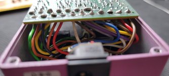

I recently picked up a "intermittently malfunctioning" OD-2. My assumption is, based on the serial number, that it's a ACA spec'd power supply pedal. Gonna first jump D1 and R2 to get it to PSA standard to see if that fixes the malfunction problem.
My primary question regards the Turbo mode. If i'm crafty enough, my dream would be to add an easier access point and fast engagement. My hope is to take the turbo knob and port it over to a latching switch somewhere. Anyone have thoughts about this?
