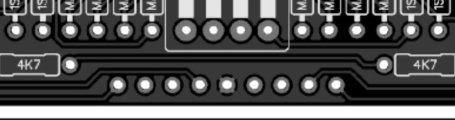

Hi all. I have a question that I think I have answered myself, but just need confirmation.
I have a Paragon build on the go, but won’t be using 3pdt/true bypass. Instead, I’ll be using DPDT switches and a couple of 3rd party optical bypass daughterboards.
Now, the Paragon board and its daughter marry up perfectly (that sounds soooo wrong) and if using both, there’s no need for the connections on either board to be labelled. But this is something that I’ll need to know if I’m going by a different route.
So, armed with a DMM set to continuity and the schematic (not my strong point), I’ve come up with this...
From left to right...
1 jack in
2 in side A
3 led / v
4 out side A
5 Ground
6 in side B
7 led / v
8 out side B
9 jack out.
Does this look right?
