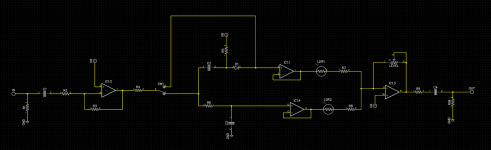

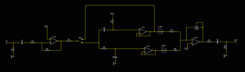

Hi all, a question for anyone more technically minded than me (all of you)

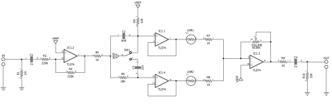

I want to add a switch to my PedalPCB pendulum pedal, similar to the switch on the Supro harmonic tremolo, which changes between harmonic tremolo and the more standard 'amplitude' tremolo. I've mocked up the below so that a switch would either allow the pedal to act normally, or bypass the filters and opamps, and pass through the optocoupler on the high pass filter side.
I also thought about bypassing the high pass filter, but still going through the opamp, and then using a diode to prevent backflow, but this is slightly more complex and I don't think the 'unsplit' signal would need this amplification.
Does anyone have any suggestions or know of any reasons why this wouldn't work?
