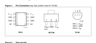

So my Poison Apple “works”, but I am getting serious popping/thumping at the envelope opening and even a little distortion on lower strings/frets. I have been pouring over this thing doing all the troubleshooting basics and the thing I keep coming back to is that my 5v keeps disappearing. So long story shorter, a continuity test between the + terminal of the power jack and the pads of the regulator beeps on both the left and middle pads, but not the far right. IMG_5742.jpeg
This would seem to indicate that the left pad is meant for the Vin. Great except the pinout for the regulator has the left pin as Vout.
And I do get continuity between the anode side of D4 and the left regulator pad. So should I just ignore the silkscreen and flip the regulator? then my question becomes why does the middle pad show continuity to the positive terminal, shouldn’t that be connected to ground (which it actually does show connection to both🤔)? Also get continuity between the left pad and the collectors of the bc550. One other oddity is that I do not get Vcc on ANY of the pads😭 Help a brain dead brother out please.
L78Lxx and L78xx have reversed pinout. Power the board up without the regulator and see which pin is hot.
If you have 9v on the center pin, you have a bridge/short somewhere
The regulator I am using is the one pictured so I’m going with there may be a short. In desperation I have off boarded the regulator on a vero and fed it into the left pad of the regulator and every thing seems to be behaving. It’s what I get for taking a build break.

The middle pin of the L78L05 is supposed to be ground. If you are getting continuity between pin 1 and 2, then your 5v supply is shorting to ground somewhere. Check anywhere that 5v is present, like Q2, Q3, and the bias pot, and downstream of these, for any stray solder or broken/bridged trace, leads not trimmed short enough etc that could cause this
