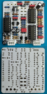

Rolling out the new builds, my next Phido Sound build is the Argand Plane, based on the EHX Small Stone, using the AionFX Sunstone PCB.
This is my first build on an AionFX pcb. The PCB layout is nice and the build directions are easy to follow (I am sure I am not the first to say that). I didn't make any modifications to the PCB build, only adding my 2nd rev PCB breakout for one of the footswitches. This is getting close to just right.
