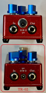

After tackling some higher count and density boards, the Rat is a very friendly build with no real opportunity to make mistakes (hello, properly polarized electrolytics). The new PCB with the SMD alternative for JFET was perfect for my bias mod, as I was able to take advantage of the through hole pins to mount my new exta resistor. On the whole pairing up the asymmetric diodes and biasing the JFET went super easy. I also used excessive quantities of flux and my Pinecil iron was up to the task of mounting the SMD JFET without it looking too horrible.
I think this is as clean a build as I've managed, with better grounding, and cleaner wiring. I still have to decide where I want to lift connectors so I can cut some out, while still being able to disconnect from the case. I did hit the connector/wire crimps with a touch of solder for robustness (see below for why).
Design

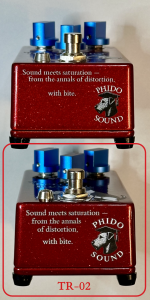

After my first iteration, which I dropped into the Players Haters Ball, I made a number of changes to the case design. Mostly successful, as the scale changes generally work. I've posted Rev 2 side by side with the original for comparison. I like all of the changes and think it works a lot better, although I still goofed the color fill on text (I think I filled with the RGB of the RDG_MATTE before I set it as a spot color) and this suffers from poor use of fill and stroke in Affinity Design 2.
New Poem
I also re-wrote the bottom poem text. In some ways, I tried to simplify the style to be more doggerel. Having written another 5 or 6 IU have a better feel for the cadence and length I need (plus I was in a hurry the first time to get the case printed so I could see how print settingds looked). I hope you like my update.
