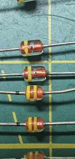

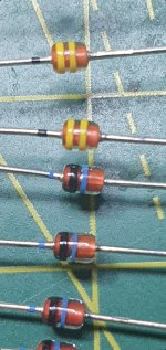

Here's a photo of the MA856 diodes I got . . . .
Ma856
MA858 next to ISS133 to show the size difference between them and the lack of a mark on the cathode lead
These were disappointingly sold to me as MA856 from a trusted retailer who later admitted they were 1ss133 when I sent them some pictures and FV readings
MA858 with MA859 next to them you can still see the mark on the cathode lead and the size are the same
According to my callipers the MA series diodes are 2.1mm x 1.6mm and the 1ss133 come in at 2.7mm x 1.8. The MAs measure from around 0.75 (MA856) - 0.79 (MA858) - 0.82 (MA859) and the 1ss133 come in closer to 0.65.
