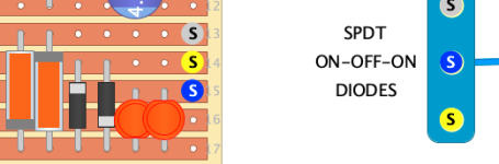

Your tayda board will work. You will need a on-off-on spdt switch. I don't have a lot of experience with p2p type boards, but you'll need to make solder bridges either way. Here is a stripboard layout of a diode selection
The bottom strip will be ground. Once you have the diodes soldered in there you will need to make a solder bridge. Strip some hookup wire and solder it to every hole on that row. Attach this portion to the right side of the pcb diode section (see above post). You can tell it's ground because the holes have a + cut in them. The switch wiring is included here too. The blue wire in the diagram will go on the left side of the pcb diode (doesn't matter if you pick D1 or D2). The LEDs should be the center lug on the switch since they have the highest voltage drop.

So I ended up doing this on the switch. 1N4148s on the top, BAT41s on the bottom. Left yellow wire went to the right pad of D2, right blue wire to the left pad of D1.
BUT....I also did this:
I soldered two red LEDs in D1 and D2 with the wires from the switch attached to the underside of the board. (Pardon the filthy board, picture was taken before I cleaned with 90% isopropyl)
-Will this work? My thought process is that while the switch is in the 'off' middle position it will use the LEDs for clipping, then in either 'on' position it will work for the respective diodes. If it won't, I'm going to desolder and go with MDCs two DPDT suggestion. Seems like fun.
I think with that arrangement you'll be good, the LED's will have the higher vf so when the switch is up or down current should flow through the other diodes with lower vf, I'm sure one of the resident Guru's will either verify or shame me soon
