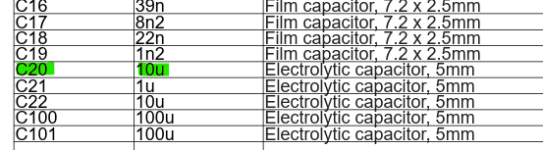

I'm putting together a Samarium Distortion (HM-3) and noticed a discrepancy between the value screen printed on the PCB (1uF) and the value listed in the documentation and on the schematic (10uF). I want to verify the 10uF is the correct value before I solder, and also make this potential issue known to others.

But both the documentation and schematic indicate that C20 should be 10uF:

Yes, that's exactly what happened.
This was corrected back in July but it looks like my first batch of boards with incorrect silkscreen didn't get trashed.
You are correct, C20 should be 10uF, C21 should be 1uF.
