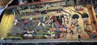

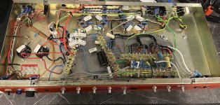

Couple years ago I was on hunt for a new amplifier and found Simms-Watts AP100 sale nearby. Amp was in good shape, played regulary and power side was recapped within 10 years. Majority of the components were original and circuit compared to schematic available.
Topology was two channels both with their own plate driven TB tone stacks, followed by two gain stages before LTP and ultralinear power amp with EL34.
Played few months with it before one power tube gave up and started modding this thing. To be continued.
