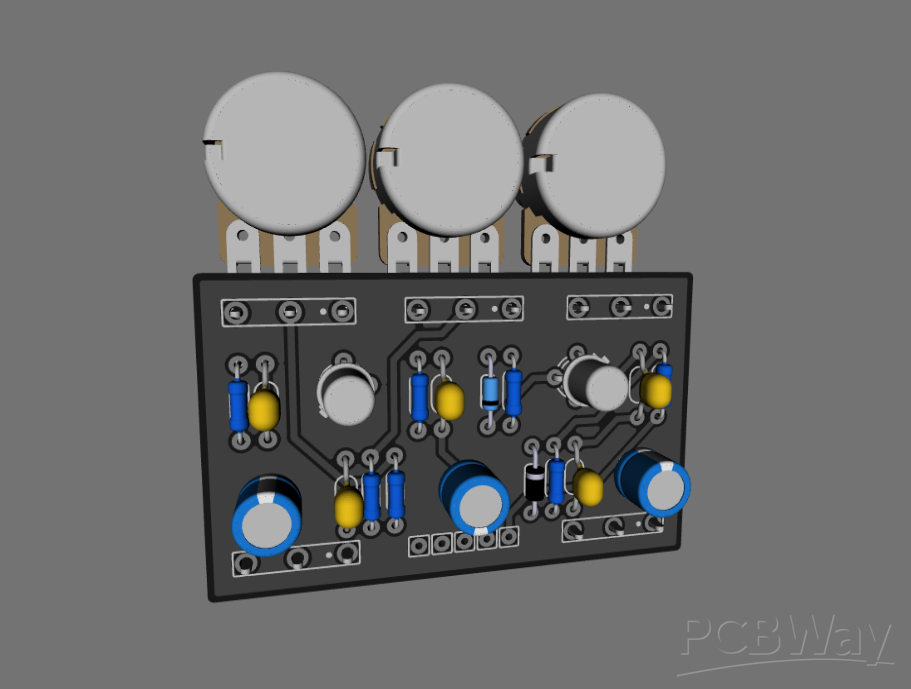

Note, it's called the Fuzz Driver and it's different from the Hybrid Fuzz Driver.
Anyone know what this is? Is it some ancient Skreddy pedal, or just something else that was mislabeled?
dirtboxlayouts.blogspot.com
I didn't find much elsewhere, I assume the PCB was maybe based on the Dirtbox Layouts post? Not sure. Someone else was wondering the same thing in that post.
It looks to me like just a NPN fuzz face, with a bass cut control on the input, voltage/sag control, and an additional bass control in the negative feedback?
But please do correct me if I understood something wrong, and especially if someone recognizes it as some other schematic that has been mislabeled?
(the 47mF should probably be uF)
Edit: EffectsLayouts too, which seems to have been posted before the others, although it has a video of the Hybrid Fuzz Driver instead which is a different circuit AFAIK http://effectslayouts.blogspot.com/2019/03/skreddy-fuzz-driver.html (also explains why there's randomly a tantalum cap in the end, it probably fits better in the perfboard layout?)
