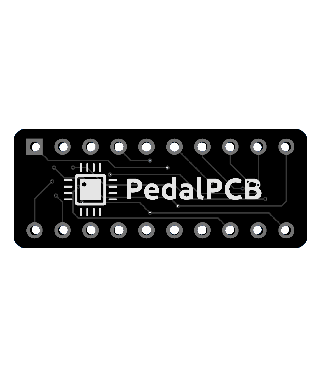

Giving some news, I've received the Muzzle kit , nice project to mount but...it doesn't work :(
After verifying with audio probe, the reason is the IC That 4305 Dip 20, I've installed it "back to belly" :poop::eek:, obviously I attempted to reverse it, but the IC is spoiled, I guess some electrical tension at bad place and it's done!
The other mistake I've done, is to solder the 20 pins on the IC PCB !!!
I've ordered another one but nowhere I find some exact way to mount it with right direction on the basement , although in this link , I see that no soldering is needed, if I understand so clearly ...
Quote:
  • Simple installation using pinheaders into original through-hole DIP-20 footprint "
Thx a lot to give me some explanations

Hi mdc,
My Muzzle pedal works now, after replacing LT1054 (IC1) ! (y)
Well , this way to plug the Muzzle like you advised doesn't work at all with my Mesa Boogie Mark 3 ! :(
The pedal has no reaction so I've choosen the way "4 cables without FX loop" like the Fortin Zuul+
So the pedal chain is:
Guitar =>Muzzle SChain in/out=> Wah=>Comp=>OD (KCentaur)=>OD(TSlike)=>OD(FriedmanBEODlike)=> In/ out "drive part " Cerberus => In / out Muzzle => Reverb => In/ out "mod part" Cerberus => Amp ( I had to put out "simu acoustic" , no too much place on pedal board)
And it seems to work but ... I've got some doubt, I've tried at home with my JTC attenuator ( I always use it !) and it doesn't remove all the buzz , if I switch on the OD "Friedman like" , it occurs more buzz, but less than switching off the Muzzle.
When I remove the Nux Cerberus of the circuit, it works pretty fine, not perfectly though... I think this Nux thingy is a pain to use with noise gate...:unsure:
So on saturday, I will rehearse with band mates, I'll appreciate it with more volume!
