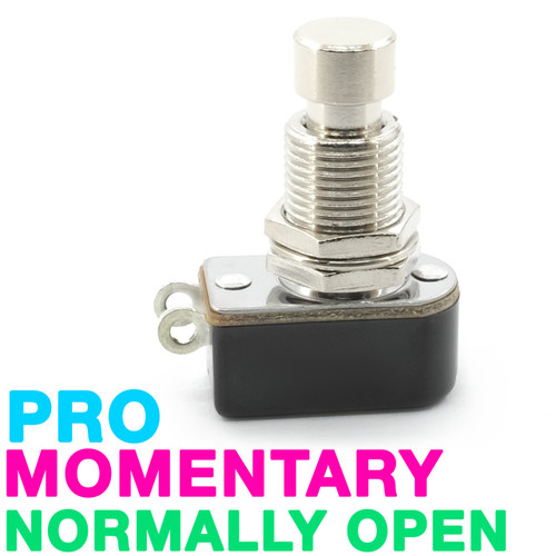

I’m finally starting to get the appeal of relay switching, however long I am into this hobby. But I don’t really have a good grasp on what SPST footswitches are available out there in the same way that I have a preference for 3PDT switches that I could opine on for far too long if someone was unfortunate enough to get me started.
What switches do you like using for relays? Does it have an audible click, how’s the amount of force required?

According to the data sheets I’ve found, a typical latching relay for this sort of application is rated for a minimum of around 10^8 cycles.
A typical SPST momentary footswitch is rated for 50,000 mechanical cycles, and if it breaks, it’s just two solder points to undo when replacing it. It also has a ‘silky smooth’ feel to actuate.
A typical 3PDT latching footswitch is rated for only 10,000 mechanical cycles, and that goes down significantly if exposed to too much heat when soldering (which is actually pretty common)— not to mention the fact that they have a fairy high random-failure rate. They also often have a clunky ‘thunk’ when you actuate them unless you buy an expensive premium footswitch. When it eventually breaks, it’s 9 solder points to undo when replacing it.

All fair points. The Taiways I source from LMS are 5 bucks a pop, 50k cycles, not too clunky.
A demont is 3x the cost, but 4x the lifespan. Can't argue with 10^8 cycles though. @4 bucks a pop for a panasonic latching relay....yeah, I can see it.
Especially given the low current requirements in switching guitar signals and LEDs...the Panasonics are rated for 10^5 cycles at 2A 30V, double that at 1A.
Yup. OK. You have my attention. That makes a lot more sense, in terms of reliability and longevity, to go the relay route over the super high end switch route. Creature comforts too...that click less actuation could be a plus, though I kinda like having that feedback in certain cases.
