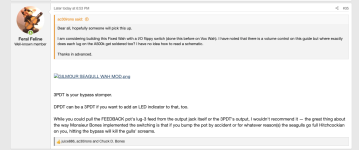

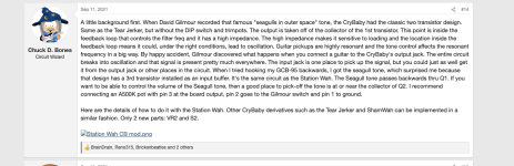

A while ago @Chuck D. Bones provided a schematic of how to implement a switch and volume to the station wah for the Gilmour Seagull mod.
Here is the thing, my dyslexic brain can’t get around schematics and I can’t visualize how to ‘actually’ implement it. Could anyone draw up a little diagram up, like you get at the end of a build doc. I am more than happy to send a few $ over, I know this stuff takes time !
Thanks in advance

Responded in Chuck D. Bones' thread.
That's a shame to hear...
I found an archived version of the thread on Web.Archive.org.
Unfortunately, the relevant posts by @Chuck D. Bones (No. 14) and @Feral Feline (No. 35) are missing the images:
View attachment 106887View attachment 106888
I'm supposed to be at a gig right now, I'll repost images later.

Can't say the same for the Seagull mod, somebody might get hurt — those things can get out of control, fast. Wailing, Shreiking, Screaming fast.
Stick a comp/limiter after it.
Screaming seagulls sequel info can be found here.
Thank you soooo much @Feral Feline!
