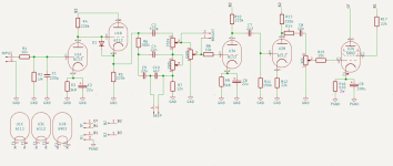

Thought I'd document some of a build I'm doing here in case anybody is interested in how you approach making custom boards/etc for an amp.
I've got a stack of submini tubes, and a guy has been harassing me about making him a mini Trainwreck-inspired head for a while. Decided to see what I could do using as many existing parts as I've got at home.
This is the schematic I'm working from - using a Wreck preamp layout, but instead of ignoring that spare triode I'm using it as a follower. Unsure why anybody wouldn't as it's free gain! I was tossing up an idea for something like switchable mids instead of that mids pot but settled on a 'deep' switch which gets rid of the scoop entirely. It might be a little too much body but I can tinker once it's built.
The cathode/plate values are very different from what people are probably used to seeing from full size tubes, but somebody else had done some pretty extensive testing and discovered 220k/3k9 gives the 6112's a very similar response to AX7's with 100k/1k5, and these can be scaled directly to emulate any other cathode resistor values - if you see most peoples submini builds they're just using AX7 values and calling it a day!
Rest of the schematic is fairly self-explanatory, but C7's value should be 10n and not 2n2. R14 is there as it made the layout simpler, but it could be replaced with a wire link if it needed to be.
