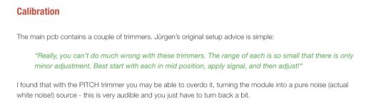

Well, the unit fires up and passes signal in bypass - but no cool phasing effect yet. So I guess those trimmers are for setting things up.
On to the calibration routine exploration.
Oh :(
The calibration process is more about details, it seems. No effect at all is strange. From the eurorack module...
I think the "1V/OCT" jack connection points need to be jumpered too. I found some other build notes that show the "1V/OCT" connection points as an input jack that is grounded when nothing is connected. So, adding another jumper to see.
Well, after futzing with the trimmer adjustments in calibration, it seems I need to troubleshoot my build. None of the user controls seem to do much of anything - yet the unit still passes sound when engaged; just filtered a good bit. The INVERT toggle changes the tone, but that's about it.
At one point when starting the calibration over the 4th time, I got a very short burst of awesome phasing. But then it just went away and I could not get it back. I may have an intermittent somewhere. More later after I get caught up on springtime household responsibilities.
