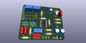

Since I wanted to learn KiCAD and PCB design, I built a version of RG Keen's signal generator. It was good learning experience, but clearly not the most compact design. It is boxed as a regular pedal so that I can alternate between the generator and a guitar.
