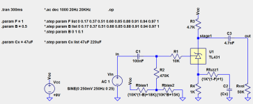

The TL431 is a "programmable zener." It has three leads: Anode, Cathode and Ref. By connecting a resistor between Anode & Ref and another between Ref & Cathode, we can dial-in any zener voltage we want between 2.5V and 36V. This device is intended to be used as a shunt regulator, not as a clipping diode or amplifier. But we pedal designers are not easily deterred from doing something crazy.
Inside the TL431 looks like this:
In some ways, it behaves like a BJT with a Vbe = 2.5V and a lot more gain than a typical BJT. I put it in a Fuzz-Face circuit, to wit:
Q1 is there to buffer the input and make the FAT knob more effective. A typical fuzz face has a gain between 70dB and 80dB. The 431 FF has a little over 90dB gain. It's kind of a fun experiment. There are other ways to get that much gain from a FF.

I expected the TL431 to be quiet and the one I plugged into my breadboard was. Full disclosure: I'm using a vintage LM431 I bought from a surplus dealer. I built a version of the circuit above. It looked like this. Sorry for LTSpice schematic, I didn't draw a nice schematic. The BIAS pot is B10K with 18K from pin 3 to Vcc and 15K from pin 1 to GND.
