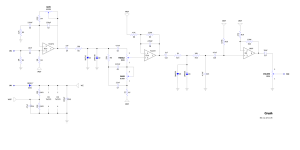

As Chuck alluded to this started when I ran my Shreddo (modded Shred Master) into the Beast (one of my fave ODs) and noticed how chunky the low end could be. I have always wanted an OD for my Strat which beefed up the low end in a way that kept the definition and Stratty twang. Not looking for loads of gain - although there sure is plenty on tap here - but more just a mega Strat sound. Can we get that in a single pedal? The Shreddo came close; this nails it. It reminds me of the tones Billy Gibbons gets with a Tele.
I had drawn up a convoluted schematic which I knew had way too many parts and as usual Chuck was a star and helped me remove a heap of bits which weren't necessary. I like this system - I have the stupid idea and Chuck says here's how we do it! He made it bigger and betterer but also more efficient and cleverer. My version is a bit simpler. On Vero it fits into a 1590B - just - and makes my Strat sound big and aggressive. Not necessarily pretty but I have other ways of achieving that. So with my Strat and a 1x12 Marshall style combo I can get things falling of shelves with the Crush (as I call mine) but still have a well defined sound with little fluff. The Shred Master's EQ works better than I could have hoped. Normally I wouldn't do EQ like this but it lets me get huge gobs of tight low end or reduce it to make my Gibsons almost sound thin. The bass control is very powerful.
This is mine. Chuck's is cleverer but mine fits into a 1590B on Vero and does what I want it too. I used an OP07 for IC2 because it doesn't need any compensating caps and I had a bunch of them. I am sure most dual opamps will work for IC1. I like hearing the clarity on the bass strings and generally use it with gain at or below 1.00. If this is a bit glassy or harsh at higher gain making C3 a bit bigger should fix that. 220pF should be enough.
I will build Chuck's version at some stage too.
*Edit* Just updated the schematic. Changes are minor.

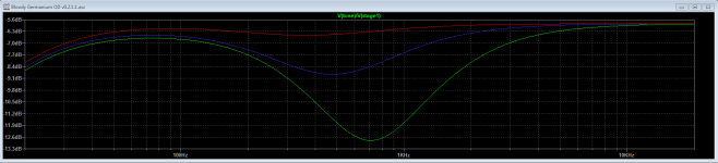

How about making the mid switch an on/off/on as well and having another cap value beside C9 / 2n7, maybe a guess like 1n5 to choose from?
Probably more like an in between setting I guess. I'm not totally a fan of deep mid scoops. And just thinking because the fat switch is also three position, so why not...

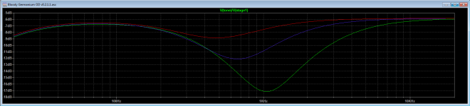

This is the Tone Stack's freq response, from U1-1 to U1-5 with BASS at 7, TREBLE at 6. Green & blue curves are the current MID switch settings. I'm thinking about adding the red curve on the 3rd position. I'll let you know how it turns out.

BTW, my last version sounded like crap with the MID switch in the deep scoop position (green curve). Way too thin. The two notches in the v0.2.3 design are just right. I'm trying one more combo and if that doesn't cut it, then I'm done.
