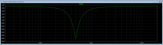

It would be interesting to see a waveform range chart for this circuit. And a question: can it be easily modified to exact a variable Q notch filter as well? I want to put a crunch circuit in front of this, but with a Q that can notch as well as bump.
