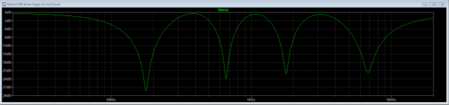

A client asked me if I'd ever heard the Roland GP8's phase shifter section. I hadn't, but I found a schematic and breadboarded one. It bares so similarity to the MXR Phase 100 in that it contains both variable and fixed phase shift stages. The Phase 100 uses LDRs and has 10 stages; the GP8 uses OTAs and has 8 stages. The GP8 uses an IR3109 quad OTA to realize the four variable phase shift stages. That part is nearly identical to the Maestro MP-1 Phaser, which begat the EQD Grand Orbiter. With a total of 8 phase shift stages, we get 4 notches that sweep up and down. This is how the overall freq response looks near the bottom of the sweep, with RESONANCE set to 0.
