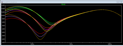

Hey all, I’m trying to get my head around tone stacks and their related components. In the schematic bellow, there are 2 x 470n caps. Now, I know that increasing the one that feeds into the bass pot will increase the bass content, but what about the one that goes to VB ? What would increasing/decreasing it do and how does it inter play with the other 470n?

The second one affects how wide the bass boost curve is, specifically by changing the low midrange scoop frequency. I can post a sim later, I would need to change the nominal Hiwatt component values as you have.
Here are some sims from my tube Hiwatt model:
Bass = .75, Mid = .8, Treb = .33 (out of 1.0), 47n cap to ground stock, then changed to 27n and 100n:

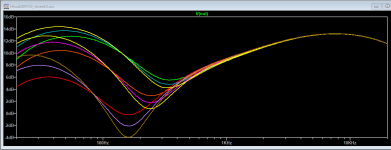

Same settings, second 47n cap also cycled between 27n, 47n. and 100n:
So if you have started at 47n - these are both 470n 😳
I used the values for a DR103 tube amp. if you have scaled them correctly to your source and load impedances the curves would be very close once scaled (i.e. 270n/470n/1uF). My particular model would be a bit of a PITA to port to a solid state format, so I’d need to at least know if you are using opamps, FETs, BJTs, etc. Do you have a whole schematic worked up yet?

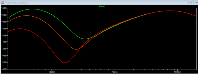

Edit: this morning I got to work on my take on a viable solid state scaling using opamps. I'm now reasonably close but still need to see your basic concept to take it further. But here's where things stand right now, using your component values, same control settings as my perevious graphs, and both caps cycled through 270n, 470n, 1uF:
Pretty danged close! ;) I had to do some tweaks around the opamps to get there, but just very simple stuff affecting high and low frequency rolloff shapes.

Dude - this is too too cleaver and quickly reminds me that I’m guessing at this stuff.
I’m very much a try it and see type. I have used a dumble type schematic (the Bajaman one that I already build.) Iv swapped out the tone stack and toggles for the stack posted. The bass pot was acting as an on/off - Iv swapped that out for a A100k and swapped the non grounded 470nf for a 1uf.
It sounds bloody great. Clean as a whistle, bags of head room. Iv also put a Violet Rams Head on the board and that smashes the shit out of it.
