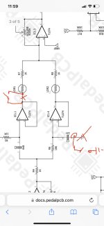

One idea, You should be able to add a toggle switch to convert the pendulum into a standard optical trem. I haven’t done this mod on the pendulum but the cardinal harmonic tremolo circuit has the same concept.
Edit: first sketch I posted wouldn’t work… something like this with a dpdt should I think

I wish I had thought of this! Maybe this will be a revision to my current design. I drew it out and got some boards done at jlcpcb that are basically are harmonic and optical trem that share an lfo, with a 4pdt on-on-on switch to toggle between harmonic and amplitude and then between smooth and choppy. This solution seems like it would simplify my design a lot, thanks.

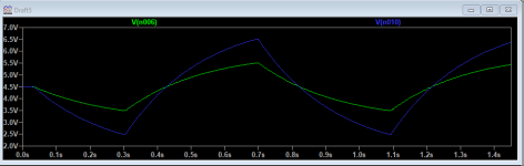

Briefly reviving this thread with an update and one more question. I finished my schematic and got some boards made and it almost works perfectly! The only issue is that the depth is quite low even when the knob is turned all the way up; the LEDs seem to be winging between ~4 and ~6 volts. A different value potentiometer did not have an effect. Any ideas on how I can make the LFO depth higher? I've attached the schematic below; it is based on the pendulum LFO and the witch affects shape like the knob on the Moonshot trem. Thanks.

What LDR and LED did you use and how are they installed?
I tried to simulate the LFOs to compare, but it wouldn't work with the switch, not sure why. Changing the R29 R30 voltage divider back to 2.7Meg slowed it down and got a wider swing like the pendulum, but I'm not sure if it would affect your waveform switch as that part wouldn't simulate for me.
Might be worth experimenting with increasing those resistors, even 1Meg was a pretty good improvement.
Thank you so much! This fixed both the depth issue and the lack of a slow rate. Not sure why I changed those values, to begin with. By the way, what program are you simulating these voltages on?
