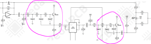

For example, here's an excerpt of Caesar Chorus (Walrus Julia) schematic (link to full schematic):
To my ignorant eyes, these are Sallen-Key filters, usually aiming for a 5kHz cutoff. That much I can ascertain.
But: why are they using BJTs? Even in "new" BBD chorus designs? Does it have something to do with the input/output impedance that makes BJTs preferred in this application over an op-amp?
Some designs have two filters in series for a second-order cutoff effect. Why duplicate the BJT design when an second-order Sallen-Key filter using an op-amp would be more efficient?
Super grateful for any insight into this!
