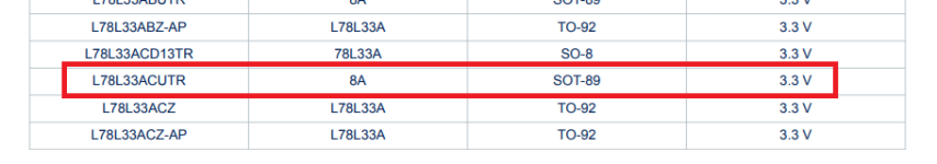

Hello, 8A423 code is this part a 78L33 regulator? I've researched it but I'm not sure. According to the data, it doesn't seem like a regulator; I'm assuming it's an NPN transistor. However, when I apply 9 volts, it gives 3.3 volts, behaving like a 78L33. But when I connect it to the input of my circuit, the diode and 47-ohm resistor get hot enough to burn out. Therefore, I don't think it's a 78L33, but the seller sent me one. Could I be wrong? I respect your opinions.

There are 3.3V regulators designed to operate on a maximum of 6V input.
The problem is, I want to confirm if this part is the right one or the wrong one. Is it a regulator transistor or a regular transistor? My circuit requires a 78L33, but I installed this part and there's a problem, so I wanted to make sure it's not a 78L33.
SMD code ID site says it’s a Torex XC6111a423, which is a “voltage detector”.
Probably not a part that’s going to be called for in a pedal.
Can confirm, that's all I found as well, but footprint doesn't match. BA prefix is usually Phillips/Onsemi iirc, but no match there. More likely a random piece of chinesium and if that's the case, who knows.
If it was something in the audio path, I’d say go ahead and experiment. I understand the ‘I’m one part short, but I really want to finish this today!!’ feeling.
But for something like a voltage regulator there’s an excellent chance slapping the wrong one in there is going to fry other correct, working components downstream.
Just order the correct regulator (and maybe a few spares for your parts drawer) from a reputable supplier, and work on something else until it shows up.
If you’re any kind of DIYer worth your salt, you will have at least 10 other half-finished projects sitting around ;)
Thank you all for your comments. Now you're saying that 8A423 isn't exactly a 78L33 3.3 volt voltage regulator, is that correct?
It's hard to say 100% with confidence..... It could be some form of 3.3V regulator, but if it's getting hot without an excessive load something is wrong.
Either it is not a regulator, can't handle 9V input, can't handle the current requirement of the FV-1, the pinout is different from the 78L33, or it's defective...
The SMD code can point to many different devices, it's difficult to say which one it is with nothing more to go on.
If it's getting hot and there's nothing else wrong with the circuit then it's not a healthy 78L33, no.
