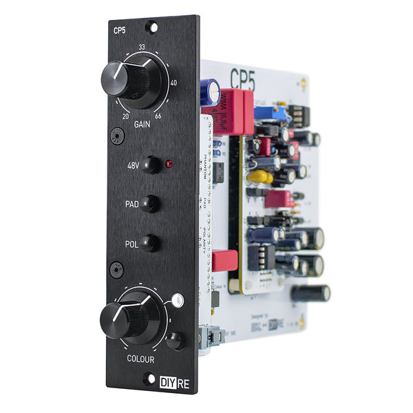

This could serve as some inspiration for your input stage.
What exactly you should do depends on what your signal chain will be. Are you expecting this to receive a raw microphone signal? If so, it will have to serve as a pre-amp as well as an fx pedal. In that case, you don't necessarily need a THAT1512, a 5532 will also do a decent job. However you need a way to unbalance the signal, the benefit of the 1512 is that the device serves as a balanced input, pre-amplifier, and unbalanced output.
