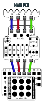

Im trying to build Aion's Fractal with a "Blend me up" circuit.
The Blend Me Up circuit came with its own 3PDT pcb, as shown in the instruction.
I dont want to use the Blend me Up 3PDT pcb, just the main pcb where the pot is located,
because with Aion projects, i need to use Aion 3PDT pcb.
Is that even possible ?
In my first wiring attempt, the status led doesn't even light up.
Between Aion's 3PDT pcb, and that extra wet/dry mixer circuit, im getting confused with the wiring, especialy with the 9V+ pads.

Did i make many mistakes ?
All observations and suggestions are welcome !
I don't think you can bypass the blend circuit without the switch as it becomes the new bypass and works between the aion board and the jacks
You'll have to hack it in with the aion daughter board for it to work
I think the power jack connections goes to the center of the aion daughter board. Then after power protection it goes out to the board at the left. If you feed 9v on the left connection, the reverse diode will stop the current.

Looks like the DC jack positive leg's connection was bad, i managed to power up the circuit.
I also modified the wiring a bit
The Blend pot works, but the dry volume level is low compared to the wet volume.
And the trimmer on the mixer circuit doesn't have any effect, although i guess it should be a volume control for the dry signal.
Not sure if it's related to the empty +9v and GND pads on the blender pcb
I do have some voltage readings on the 2N5457
Assuming the square pad is D, it reads :
D = 9.46V
S = 5.15V
G = 4.45V
Turning the trimmer fully CW or CCW doesnt affect the readings.
I'm guessing it should affect the readings ?

From what i experience with this wiring setup (see attached files),
The first part of the Blender circuit from C1 to Q1 is buffering the signal before going into the overdrive circuit,
without the Blender 3PDT bypass switch, i cant turn it off.
Yet the build is still true bypass, if i unplugg the power cable it still passes signal when it's switched off.
The trimmer isn't biasing the FET transistor like i thought at first glance,
it's allowing to add resistance between the Fractal circuit output, and the Blender output, right ?
I turned that trimmer fully CCW to lower the overdrive signal volume, in order to get more usable sounds and a better range of action from the Blend control, with a better clean/wet ratio.
But if i am not mistaking, i need to turn the trimmer fully CW and get it to 0 resistance if i want the original overdrive volume.
When they say we can adjust the Blender's output volume with the trimpot, they really mean we can decrease the main circuit's volume.
We cant increase it, and we cant affect the clean signal with the trimpot.
Am i wrong ?
