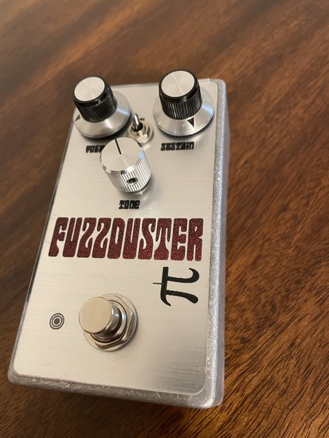

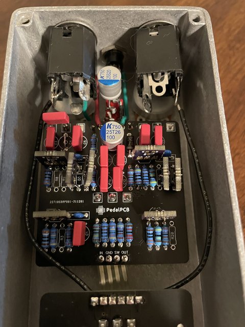

I liked my design from Chuck's contest so much I got a PPCB Muffin board and got it all boxed up.
The schematic is in the link, but the general idea is it's pretty much a Big Muff made over with all JFET transistors - including using them for the clipping diodes. The tone control is modified to a simple treble cut instead of the typical scooped Muff sound, so it really cuts through.
I also added a switch to take the source bypass cap on the first stage out of the circuit to make a 'high gain/low gain' toggle.
Ended up using BF862 JFETs since I have a pretty good stash. The minimum IDSS on these is 10mA, so I dropped to a 2.7K resistor on the drain since I've got a lot of resistor values in stock below 1K. The source resistors ended up between 330R and 470R and the drain voltages around 5.5V.
