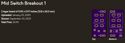

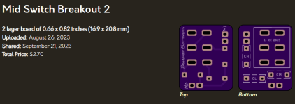

I'm experimenting with a modified Fuzz Face circuit and I'd like to have a 3 way switch that goes between 2 capacitor values plus an off position that acts as if there was no connection. This will be placed across the Base and Collector of Q1 as a 2 position LPF and no LPF. Would this be the correct switch to use and if so, how would I wire it to achieve the result I'm after?
