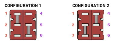

3 way switch for 2 different capacitor values plus off position

This is what I thought and did the math for 2 caps in parallel, but when I asked for confirmation, Jwin615 said:
But the diagram he posted says:
Maybe I'm just thick, but how is this not a contradiction?
Well, we seem to all call a switch a DPDT even though it's actually a DP3T;
If the bat can only move to 2 positions and there are only two poles, it's a DPDT;
If there are 3 positions it's a DualPole3Throw, DP3T...
There are many types of switches, many configurations for a given number of poles/lugs and umpteen ways to wire 'm.
I read your detailed explanation (thank you!!) and re-read the datasheet, but I'm still not clear on whether the switch I linked to is type 1 or type 2?
Look at the middle toggle position on the Datasheet and see which numbers are connected (remember, Tayda's datasheet at least has the lug numbers correct even if they go in reverse order, 6>1 — flip it round you'll see then it's in correct 1>6.
SO, knowing that and looking at the datasheet it says in the middle toggle position 2to3 and 4to5 are connected:
So, potentially, if Tayda's DATASHEET-writer was looking at the lugs from the bottom and not "through the top" ... then it's a Type 2.
This would matter if you had a PCB that called for one type of switch or the other, but since you're (as far as I know) wiring this up on your oddy knocky then it doesn't matter because you can adapt your wiring to suit whichever switch you get.
Once you have the switch in hand, put the toggle to the middle position and check the lugs for continuity — if there's a beep when you touch the probes to lugs 2&3 and 4&5, then you have a TYPE-2 DP3T.
this seems straightforward. If I used a 220 pF cap across the top lugs and a 680 pF cap across the bottom lugs with a diagonal jumper, the cap values would remain at face value without any parallel summing math, correct? And just to confirm...this diagram uses a type 1 switch?

If I'm reading this correctly, the Type 1 example in this last diagram, is the same configuration as the previous diagram where the diagonal (in this case 10nF) cap could be replace with a jumper?

Yes, indeed-oh.
Yes, for this project, Oddy Knocky is the way. I will order some switches and warm up my multimeter....
