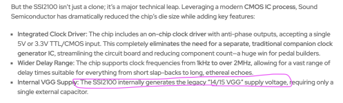

According to the linked web-page, Guitar Bomb, the 5v is just for the clock...
Note the text I circled in magenta; Legitimate Question: Am I missing something above?

If it has a built-in clock, why does it have a Clock pin (pin #8)?
I was trying to to figure this out, too - I think what it means is that in the "classic" BBDs there are two separate clock pins
that step back and forth, leading to potentially more complicated offboard circuitry, where this chip just has a single clock
pin that expects a square wave input. Ultimately the point of the device is to dynamically vary the delay and the only way to do
that is by changing the clock. (Though I guess they could do some kind of voltage controlled oscillator input directly)
It looks like there's no getting away from some kind of external clock driver, though hopefully it's much simpler than the
V3102 and/or CD4047 to drive the clock. (e.g. Maybe we could get away with a simple 555 timer, etc)
Good question. I guess internally generated Vgg doesn't automatically cancel this requirement from the datasheet:
ABSOLUTE MAXIMUM RATINGS, Maximum Voltage into Pins - 7V. But I might be wrong.

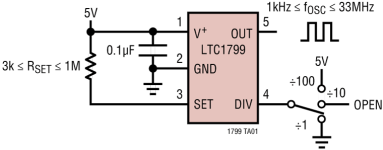

I think the LTC1799 would be a suitable clock. It, a pot, 1 cap and 1 resistor is all it would take to have variable clock.

Note, the 1799 goes from 1kHz to 33MHz, hence the one resistor(in series with the pot as a variable resistor between pins 1 and 3)
Edit: oops, completely ignored the DIV pin
Probably still need a resistor though.
