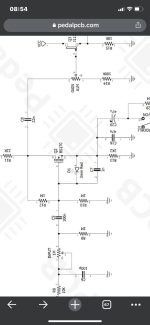

Just looking to get smarter here. What is the purpose of the red diode in combo with the. BS170? Is this some sort of clipping before the opamp?

It's ESD protection. MOSFET gates are easily damaged by static. Any MOSFET that has a short path from the gate to a jack should be protected. A 1N4148 does not provide adequate protection. A zener rated for 13V or lower is preferred, but LEDs also work because their reverse breakdown voltage is under 10V.
