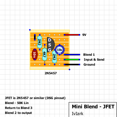

I would work one problem at a time. You need to find out why you got smoke and, more importantly, did the smoke damage something. I'd isolate it on a breadboard and check voltages first. When you are sure in your mind that the Jfet is ok, then I'd start worrying about how to fly it into the existing circuit.

PS: Your particular blend circuit is explained in Post #21. Here's a schematic to it:

This is a perfect opportunity to use a breadboard. If you ran 9 volts to one of the pot lugs then the schematic is a clue to what you are possibly facing. The schematic tells the story.

I barely know what I'm talking about, (and I keep hoping that more experienced builders will weigh in!!! Hello, [tap, tap] is this thing on?) but my suspicion is that the negative side of that 10uf capacitor saw +9v DC, or some part of it. If that is the case then it is possible that that is the source of the savory aroma of "Oops" that you experienced. You can Google "what happens when electrolytic capacitors are installed backwards" to learn a little about the issue. But I'm not positive, just suspicious.
In any case, this is a simple circuit to run and test. You plug the 9v node into the breadboard power rail and you plug the ground into the negative rail and then hook those rails to the respective ends of a fresh 9v battery. Then you just read voltages at the drain and the gate (referenced to ground, of course). If you don't understand why that is important, definitely read up on Jfet transistors and how they work.
As you can see by the schematic, the drain should get 9 volts and the entrance to the gate is a voltage divider so that should get exactly half of the voltage that the drain is receiving. Make sense?

The point of breadboarding is to see if your blender still works as it should. Does it have 9v where it's supposed to, does it have half voltage where its supposed to, is the electrolytic still functioning. That is a separate issue from how to fly this circuit into the host pedal. And I think how you could most effectively wire it is covered in this thread by someone else who is using the exact same blender circuit that you are using (Post #21 and on).
You could actually use the breadboard to test this as well. Just clip in wires to the suggested locations in the host pedal and see what happens. You can fly +9 volts and ground from the host pedal to the breadboard power rail. And then start the experiment.
Your 3pdt is just a switch that drops the blender circuit in and out of the host pedal on command, right? The 3pdt had to be connected to the host circuit somehow. But it sounds like what you are trying to do is make the blender circuit always on while the pedal is on, so adding an additional 3pdt may not be the right solution for you.

(also, the thing that's been nagging at me is your wires. You have too many of them. That's why it looked so odd.

Your input and send are the same thing. You are scavenging a guitar signal from the host pedal so that the blender can process it. Only one wire comes into the circuit, not two. Then when you've got the signal and the circuit has done its magic, you send it back. Wiring pots always confuses me, but this thread will explain all that.)

As to your wires. Your picture shows that you have 9 wires coming off the circuit. As I look at the schematic, I can only see seven wires at most (and one is redundant in this specific case). There should be a (1) +9v, (2) a ground, an (3) input, a (4) send connected to the input, and then three wires to connect the SFB to the three lugs of a pot. What do the other two wires on your board do?

And a followup question: Have you checked the continuity between all the wires that are supposed to be connected by the circuit and all the traces. I just see a lot of solder globs that could be touching other circuits, and your pot wires look like they aren't going to the right places on the output side of things. It almost looks like white #2 is connected to 9v and like white #3 is connected to both of the other blue wires. This is where color coding wires is really helpful in preventing mistakes.

Sorry, juust got back to this. The extra two wires are send and return. This is also the past circuit ive made that i had mentioned placing wires in the wrong postions
