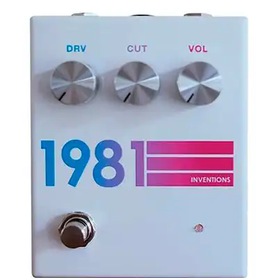

Effects Layout Tracksuit / 1981 Innovations DRV
This pedal used to be a big 'flavor of the month' on TGP a while ago. I think it's a bit overhyped, but it certainly offers a nice-sounding RAT variation. It's somewhat like a 'nicer' sister to the Madbean RAT pedal that I also built last year. I called it 1989 because, well, I wasn't born in 1981. The gradient color on the 1989 text is borrowed from my favorite 1981 color variation.
