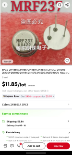

Not sure what the problem is but those transistors look like AliExpress knockoffs.
View attachment 102190 Did you measure them for leakage by chance?
I purchased them from a well known e-shop (banzai) in EU. Anyway tested them in the RM position for normal functioning since I have no transistor measurement tool. The functioned properly in the RM position.
