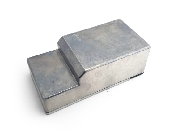

Hi all,
I'm wondering if anyone has any experience in making their own belt-pack pedal(s)?
I have kind of an unusual circumstance. I have a new acoustic inbound which has a K&K Pure Mini pickup installed. General consensus is that it will sound its best running thru some sort of preamp. K&K does make their own Pure Preamp for this purpose, which is designed to be belt-mounted. Ginsly's Acoustic Preamp is the equivalent here at PedalPCB.
I won't bore you with the details, but in my particular circumstances some kind of belt-mounted device is probably the simplest solution, so I have a few questions along those lines.
1.) I'd plan on just using as an always-on device with a switched-jack battery disconnect. Omitting the footswitch (but adding a 9V battery), I'm curious as to what would be the smallest-sized enclosure that could conceivably fit
2.) I'm wondering if anyone has any tips or tricks to get lower-profile controls. Standard 16mm pots with "typical" mounting configuration is going to protrude a fair amount and I would worry that you might get your settings jostled around given the belt-mounted nature of the device. I guess there are a few solutions for lock-knobs or simple rubber washers or something, but it would be pretty nifty to get a lower-profile look like is often done with semi-recessed 9mm pot shafts or the like.
3.) I guess probably the simplest thing to do would be to rivet or bolt a belt clip to the lid or something, but I haven't given that a ton of thought just yet. Open to ideas for the best way to accomplish that.
I'm mostly brainstorming and gathering ideas at this point but curious to see if anyone's got any inspiration or pointers!
