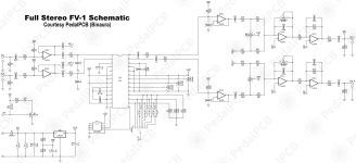

[Apologies if this should go in the Spin FV dev forum] Just finished building a Binaura. Using an EEPROM from MAS Effects (per this post).
I'm getting sound output, but vanilla -- no effects at all.
Tracing the signal, it dies at the Spin-FV chip. Signal's going in but it's not coming out. Voltages are correct (3.3V at AVDD, DVDD, and REFP). Could it be a faulty EEPROM?
Thanks!
