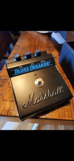

Oh, I certainly know the Musikding circuit sounds good... But I have it in a big, ugly 1590bb enclosure and it's kind of a cheap kit... I want to build one nice and tidy using the Pedalpcb board but installing all values from the musikding version (they are different). I just wanted to be sure

I've already built the Musikding version... I love the way it sounds... When I shot it out against a legit Marshall Bluesbreaker and a Morning Glory, took them off the board and kept the Musikding on there...
