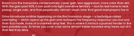

Perfect kit, everything there and planned for with a very nice fit and flow.
I think a tone control would be nice
With the esquire straight in it is as bright as the sun
With P90's in my LP special it lightens a darker guitar perfectly
It does what it says but as many would think none of the three are stellar but all three are solid and usable.
