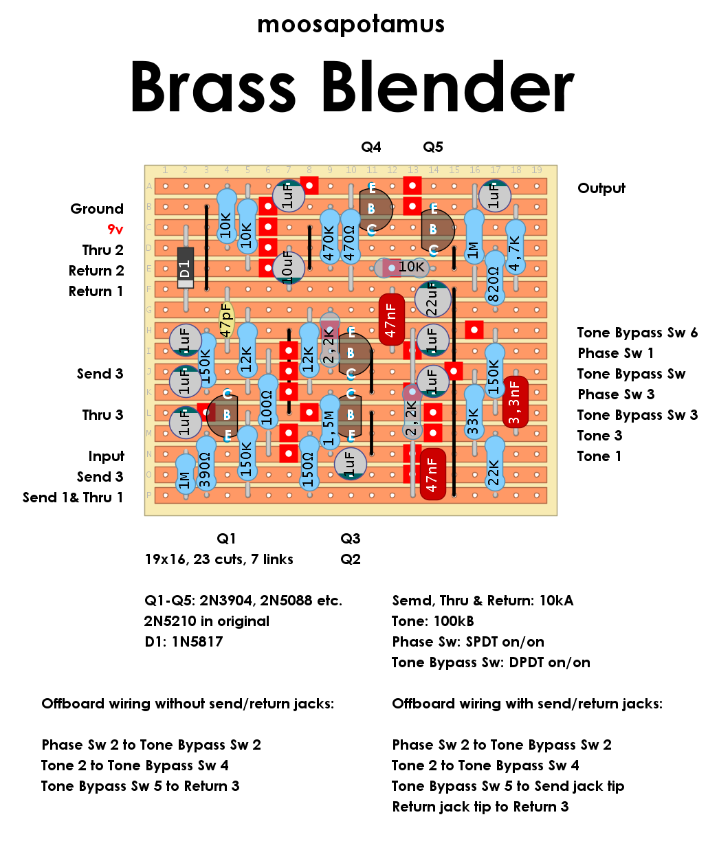

So, I tried the Brass Blender stripboard layout and was rather pleased with the result. I had some troubleshooting to do but was user error. I didn’t cut one of the tracks fully and hooked up one of the pot lugs to the incorrect hole. The wiring is kind of a mess and WAAAY too long, but I will trim it down when I decide to box this up. For those of you interested I hooked this up to my breadboard with the bazz fuss circuit to test the looper and works great.

The Moosapotamus Brass Blender. The wiring was a pain, but it works. What made it messy was the grounding and power to the led and circuit. Accidentally wired the tone control backwards but was a simple fix. I still need to put knobs on and paint it, but the hardware side is basically complete. First time putting in a yellow led and I kind of like it. Oh, and I didn’t even need to trim the BJTs!!!
