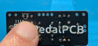

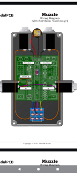

This is potentially more of a sanity check than anything else. I'm building a muzzle, and I'm using a basic relay, as well as a simple jfet buffer for what I hope is the input. I heard this circuit likes a buffered input so I figured internally would be good.
It's just occurred to me that the input for this circuit is actually the side Jack if I'm planning to use this in 4 cable method..so the buffer on the input needs to be between the side chain input and the relay, do I have that right?
And if I took it out of 4cable, say if I wanted to just use two cables, I would use the top jacks, and I would in this case lose the buffer, which I'm sure is fine. Or would I use the two side jacks and not the top jacks?
I should probably get some sleep.
Just so everyone knows, it's smart to attach the footswitch to the relay before you solder the relay board to the PCB using resistor wires. If I haven't broken a connection on this project, between the offboard switch, relocated led and this other stuff I'm jamming in it it will be a miracle.
Someone correct me if I’m wrong here but technically I believe the muzzle already has an input buffer
and that “feeds” a “buffered” signal to the key when side chain isn’t used, so I think you could put a buffer on the key/ side chain input but I have no Idea how that will interact with the circuit when the side chain isn’t in use. And a buffer would probably only be relevant on the key input if it only sees a signal directly from the guitar without any other circuits in between or a long cable run. At least that’s how I understand it. One concern I would have (probably just being extra paranoid here) is you are not filtering the power to that buffer you are just tapping the 9v jack, Worse case scenario you cook the 4301and that’s a bad day right there.
It’s probably a reasonable gamble but for what it’s worth in my opinion you are gambling with an expensive hard to find IC if it’s a real 4301. Which at first glance appears to be. (Good find!)
I had also suspected that there would already be a buffer....sorry my schematic reading isn't good enough to recognise one when I see it.
Even better I'll just pull it entirely. 👍
